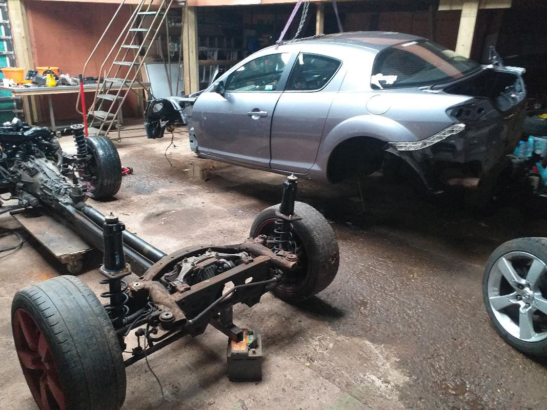

    bit of a long story  but i inherited an Rx8  and dident really need another daily driver but wanted to do something with it, l like the way the front and rear subframes detach carrying all the suspension with them  along with the power frame linking the front and rear (almost) solidly

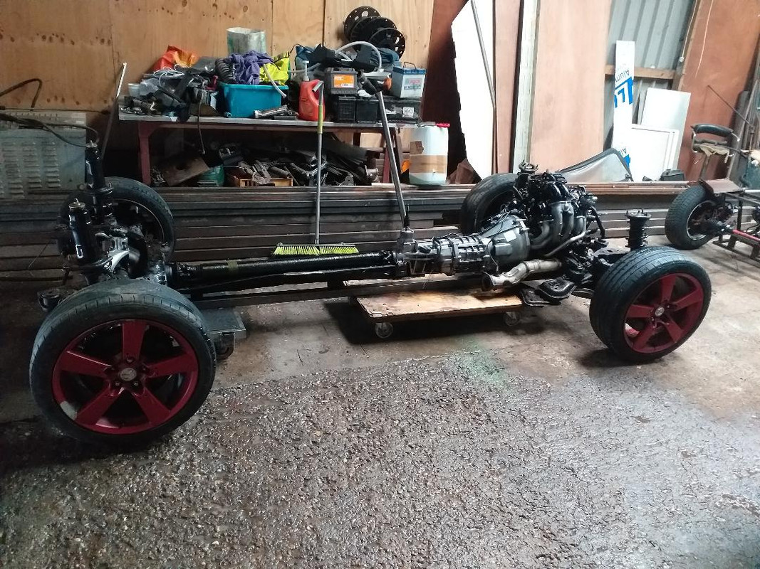

anyway it looked a good candidate for a  bit of a project soooo....   go kart for the back lawn was the answer   not really interested in making it road legal   ( well at this point anyway )    first thing i did was to drain the fluids then roll the car on its side and weld a length of box section from  front to back joining the front subframe to the back subframe making sure that they could not move in relation to each other, i relise the power frame should be doing that but if the engine mounts are shot then it will flop about like a floppy thing  :)    while it was on its side i removed all the nuts that hold both the front and rear subframes in place disconnected the steering etc   but left the top shock absorber mounts connected so i could gently lower  the car back on to its wheels with them all crashing out to the floor before i was ready,  once back on its wheels i undid  the shock top fixings   so i could just lift the body off leaving the complete drive train on the floor with the subframes locked in their relative positions to each other ....
so then the decisions start to have to be made......     looks very long    so should i should i shorten the wheelbase   etc etc

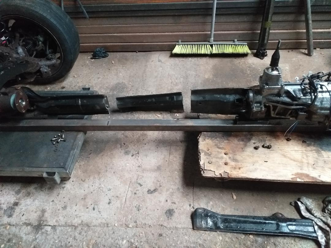

looked a bit long at the original 106" wheelbase
something around 89" wheelbase seemed a good idea   so i took 17" out of the power frame

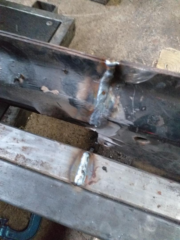

that power frame is  such an irregular shape its hard to shorten it neatly,
its also full of lumps of steel, so whats all that about then ?  some sort of vibration damping ?
anyway i removed 17"  from the power frame  and glued it back together temporary  as i am pretty sure its going to have to shortened again as when i sit in the seat the gear lever is to far forward  and wants to come back 6" or so

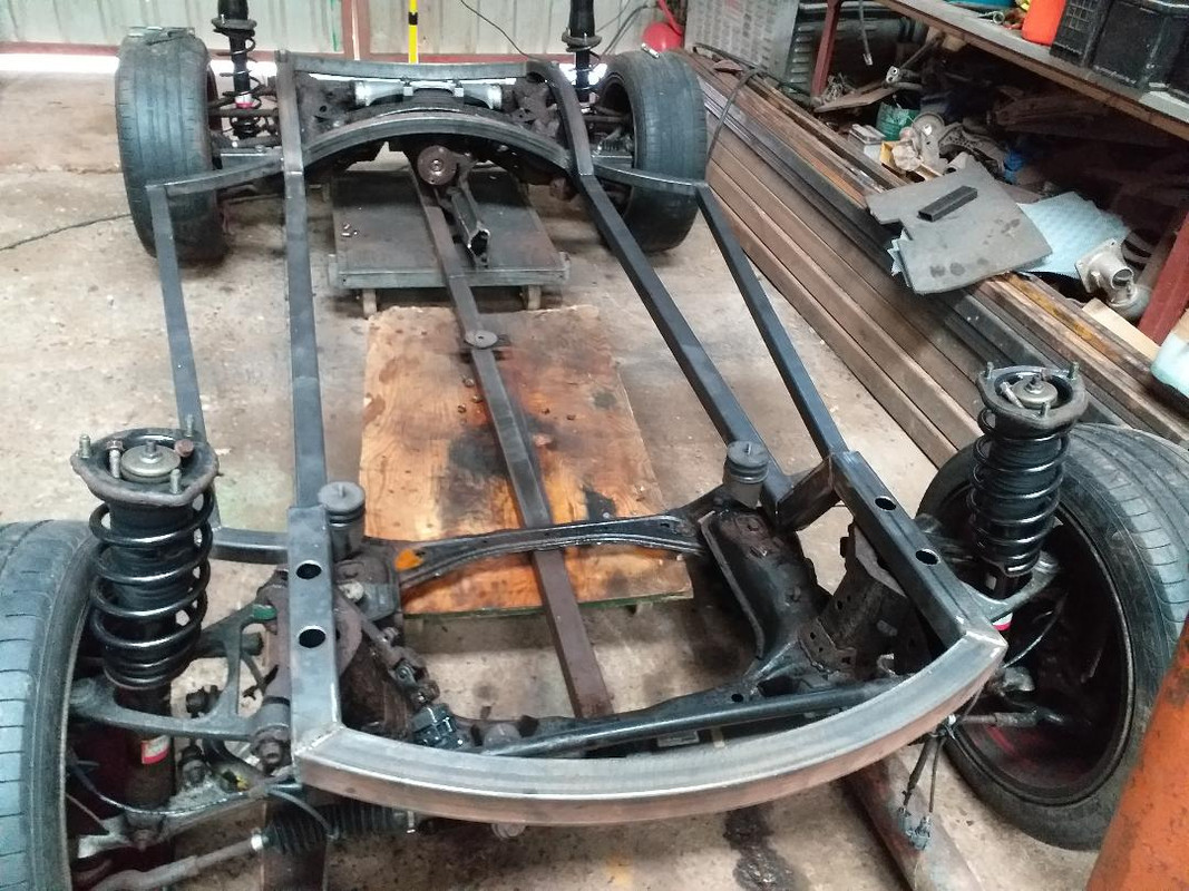

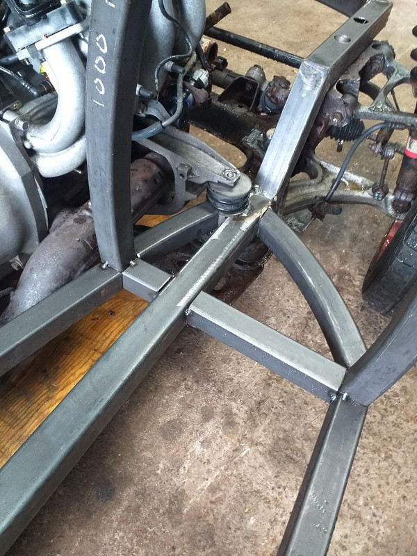

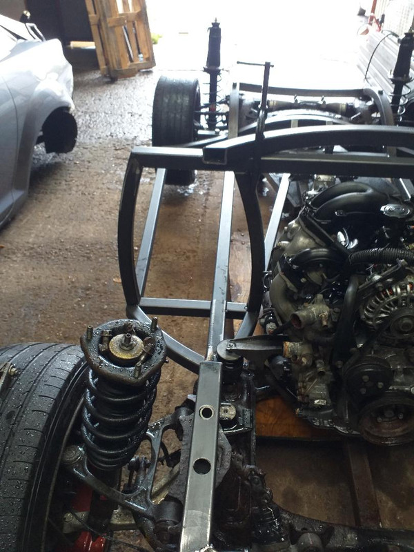

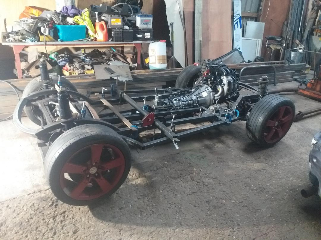

      will do,   base frame is more or less decided, will make a spit and put it on that so i can weld the underneath next week ....

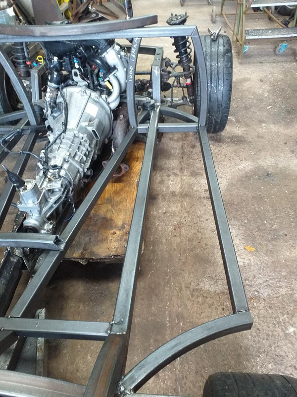

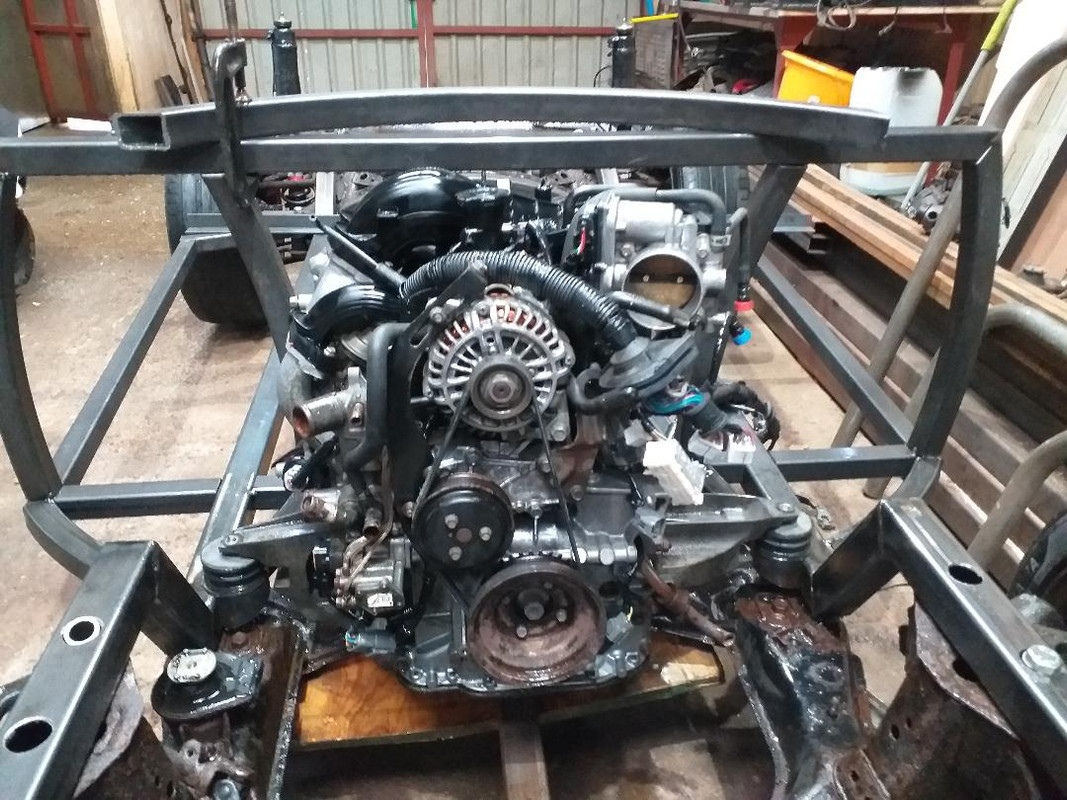

made some new engine mounts and  moved the engine/box back 8"

Mr Spiller
Wow
Nice job
You've been busy
