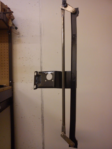

To get something else to think of, I started fixing the fan package.
And the wiper parts
