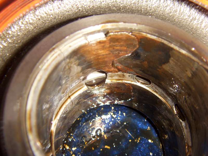

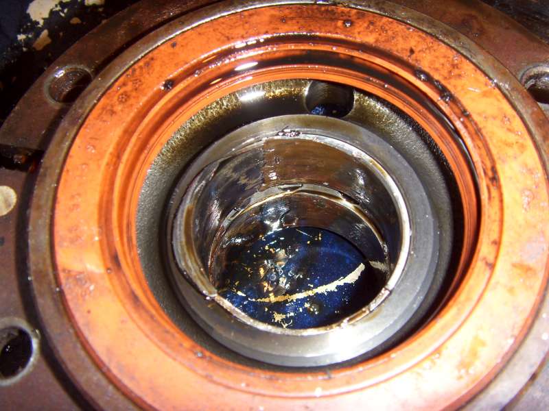

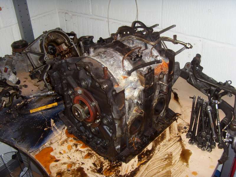

so finally got round to getting the engine broken down, and found that the rotors, housing and plates all look to be good.  Very good.  stupidly so.
"Odd", methinks, "it wouldn\'t start for anything, yet it all looks OK".

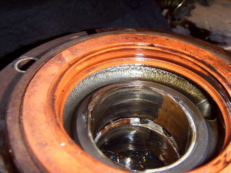

However, I have found the bit below looks like it\'s fubar\'d:
now I haven\'t looked into what this bit is, and why this would stop an engine working.  However, everything else is shiny and good (just needs a bloody good clean.  The housings look too good, if anything!  The rear rotorseals are a bit sticky, but freed up easily enough.
Any thoughts??
((other than, well while it\'s out, lets go get a 1/2 bridge...))
Prof
Is that the bearing in the rear iron stationary gear ?
Looks like it spun.  It\'s replaceable at least - so that \'s good news ;)
Everything look good under the front cover (Torrington bearings, front bearing and so on) ?
"Plus this engine is probably one of the most volumetric engines going! It passes more air than a herd of cows eating vindaloo\'s" - courtesy of AtomicRex
Yup, everything else looks too good.  Til I saw that, I assumed everything was fine and I\'d broken a perfectly good engine.  Slight scoring on the shaft - reckon it needs replacing?
Brett
As the Prof says - the bearing has spun.
Any damage on the shaft?
Brap Brap Brap Brap
yeah, slight pitting in places - does that mean it\'s dead?
Prof
Not sure how much you can get away with on the e-shaft - certainly the parts of it that spin in the bearings needs to be in good order.  I am guessing if you have that damage on the bearing - it may have started to wear on the shaft, but the bearing inserts are a lot softer.
Any sign that it \'s had oil starvation?
and such a sign would be.... ((i\'ve not done an engine of any kind before.  Like "it looks like it spun a bearing" gets a reaction of "Oh, good.  They\'re supposed to spin"....  Turns out a spun bearing is bad!))
Prof
There are oil pathways that guide the oil onto the bearing centre - that\'s the holes you see in the centre - obviously in the ideal world the shaft spins inside the fixed bearing on a film of oil.  If the oil pathway got blocked, or pickup failed for a prolonged period (low oil level, or doing the wall of death maybe ;) ), then the oil flow to the bearing may have stopped, causing the shaft to grip on the bearing and pull it around with it.  But you may see signs of discolouration elsewhere - indicating heating maybe ?
