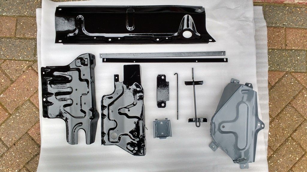

Oh well, whilst I was doing some derusting and tarting up, I removed some other bits to treat too:
Before;
After full POR15 prep and paint (x2 coats):
