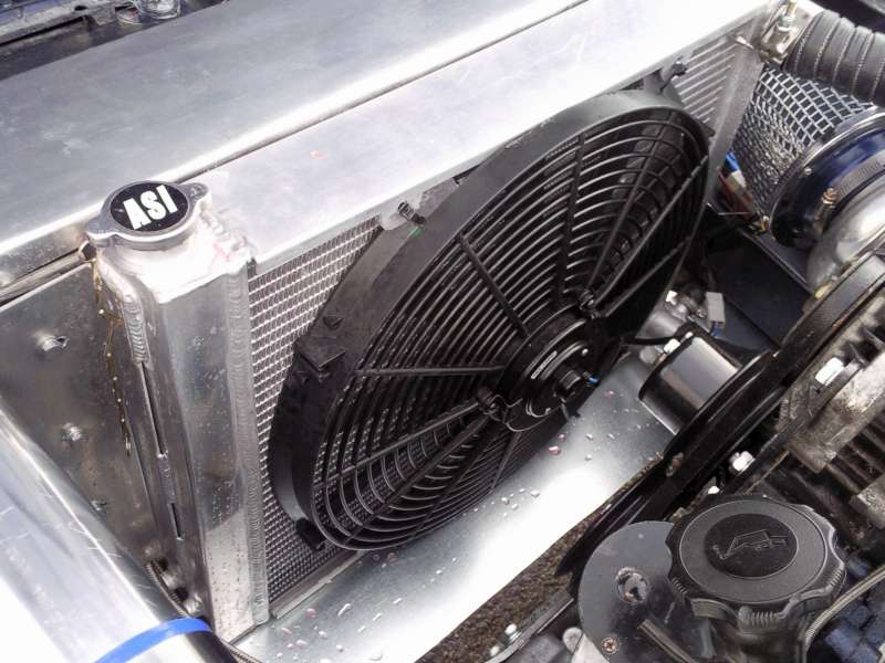

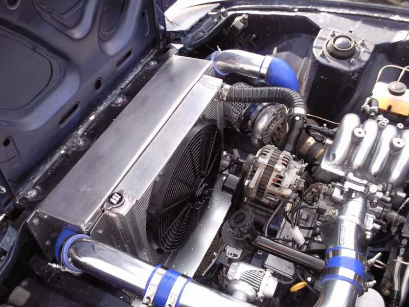

here\'s the rad as is.  Shrouding will help, but I don\'t think it\'ll make a massive difference given the area covered...  Opinions (I\'m happy to be proven wrong by experience...)
antnicuk
you have to remember that the centre 8 inches of the fan doesnt move any air when its fitted like that.   Also,  although its a large diameter fan, it doesnt look like a very big CFM one?  any ideas what it flows?
It would be interesting to see what happens if you just bolted the stock 13b one in there,  i tried several BIG electric fans and the stock viscous fan was always the best.
Looks like a nice instal.
does the temp keep creeping up with the fan running?

to be fair, your rad and fan look pretty much the same as mine, and I have mine mounted that way too.

Tis indeed a nice bit of work in the engine bay :)
The rad fan looks to be the same exact model I have - it\'s a 16" 3000 CFM FAN, and is a puller (although you can reverse the electical contacts and the blades to run it on the front side of the rad/intercooler as a pusher).
Given my experiences with the fan on idle, it should hold the temperatures down - in Bish\'s case, because the rad is smaller than mine, his fan covers an even greater percentage of the surface area - so I don\'t think airflow is the issue.
