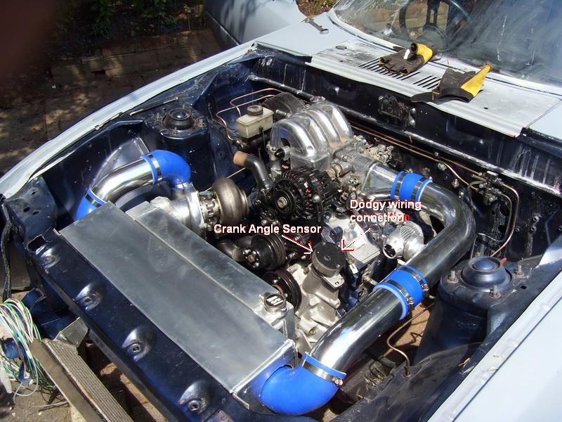

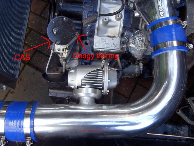

It has sounded like the CAS might well be playing up.  The T2 engine I bought for the S4 had similar symptoms to yours (would drive along OK, but sometimes cut out).  During the work, I noticed the wires from the CAS had perished, and the insulation had flexed away - which meant it could short quite easily.  This could certainly cause the issue by not telling the ECU when to fire the sparks at all, or erroneously...

ah another new idea. Awesome arch. Whats the CAS? never heard of it.

#44
This is where it is.  4 wires come out of it, and on mine, two were stripped and their shorting may well have been the problem.
