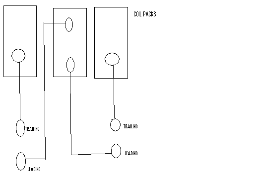

RobbieRX-7
Have you got the leads the right way round mate?
Jim_rx7
Ones with white marks to the left, others to the right? If facing them side on from passengers wing. Blue leads on top, black at bottom.
that right?
RobbieRX-7
Well this is a diagram i drawed up when stripping my motor.
Jim_rx7
That means nothing to me mate.
You near your car?
I\'m sure white striped ones goto the left and blue plugs at the top.
Anyone confirm?
interloper393
blue at the top, black at the bottom.. cant really go wrong bud, the cables are on the same side as the plugs..
