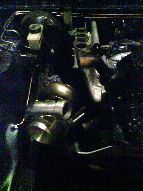

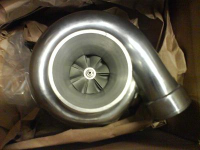

It\'s a budget OBX one (£287 delivered).  I\'m not expecting Greddy or HKS quality, but then I\'m not planning to run it at those kind of pressures.  It\'s a sleeve bearing type, as for the money, I\'d rather have one that doesn\'t require such tight tolerances.  Will be interesting to see how it all hangs together...
So, wastegates.  Why is a tial one 5 times more expensive than, say, a bailey one?

Cool - where would one consider purchasing such an item?  what does the original look like?

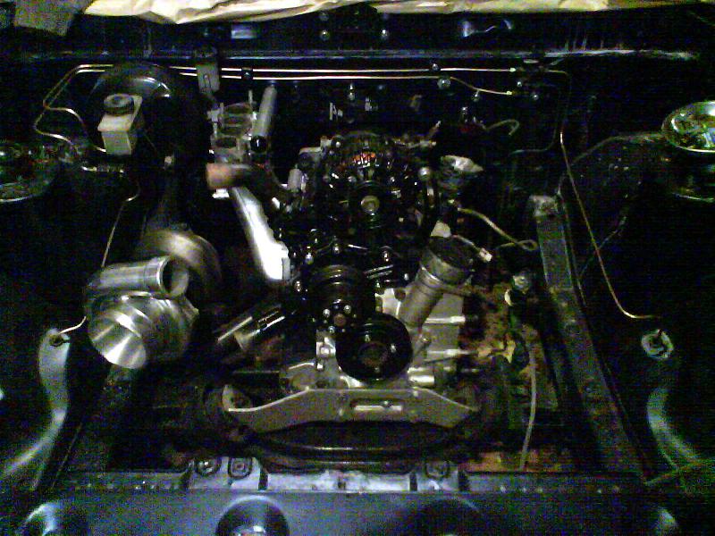

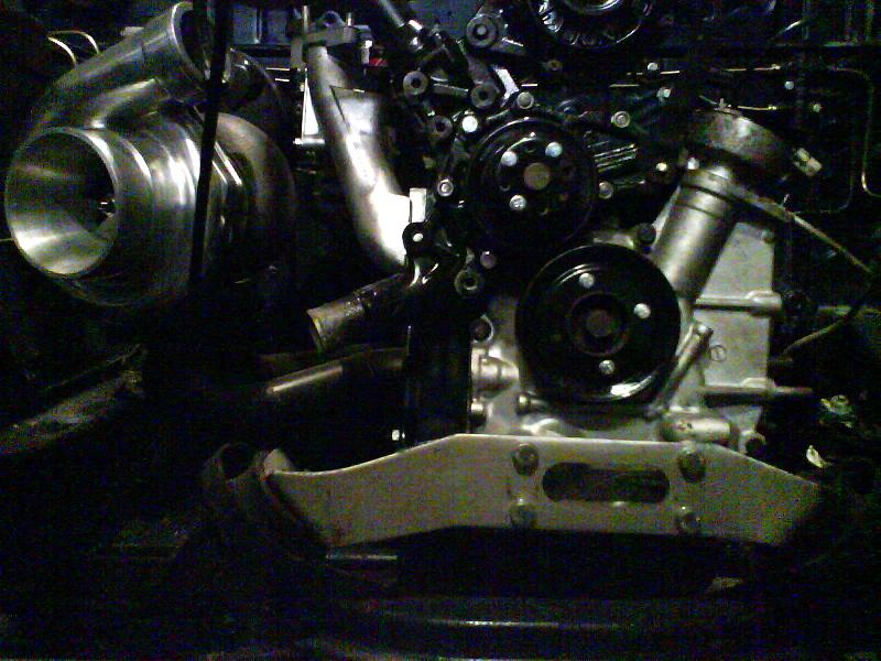

Dummy mounted, but it looks SWEET!!!  Any hints and tips on mounting it?
 - what kinda bolts should I use, or are normal machine bolts OK?
 - there are T04 gaskets - should I use one, or will that cause problems?
 - the oil feed & return holes seems to have a round hole on one side and a square on the other - does it matter which one is used as a feed and which as a return? (I\'m assuming it does...)
 - I need to turn the compressor housing around to face vertical - I assume I can just unbolt that housing, turn and retighten???
I thought I\'d have fewer queries after getting the turbo, not more...!!

the square hole is the oil return, the round one the oil feed.
Yes just unbolt the housing and turn
