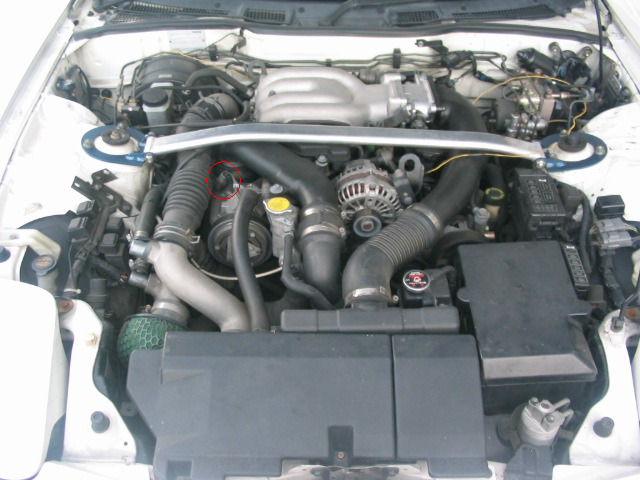

Spotlamp
One quick thing you could try is removing the cold startup water hose that connects to the back of the intake plenum.  It\'s really easy to find, it\'s on the opposite side of the plenum (towards the rear of the car) as the throttle.  It\'s a black pipe around 10mm in diameter held on with one of those naff clips.  Remove this pipe and check the coolant level (from the thermostat housing).  You may - upon removing the cold startup pipe - hear a burbling, which would be air being released, fill up from the main point until full, reconnect the cold startup pipe and see how you go.  One thing to note, this pipe is the highest point on the system, so should get most air out, but there can still be some trapped so you may need to do it a couple of times between a very short drive (so water isn\'t boiling).
HTH
