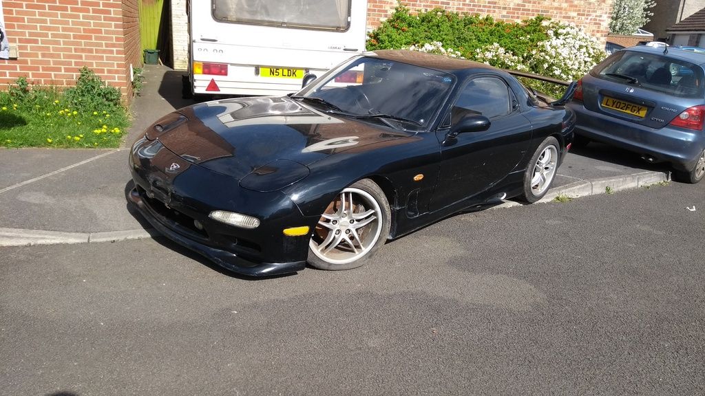

Hello everyone.
Bought this rx7 about a month ago, its been sat for 8 years and will hopefully be on the road again soon.( Currently at rx motors having a bit of work done)
Heres some pics of when i got it home.
Basicly we got the car home and it wouldnt start.  we did take the plugs out and put some atf fluid in the engine and rotate it ,just incase. we then found out the fuel pump was seized so we replaced that and it sounded like it wanted to run so then we put a set of new spark plugs in and she fired straight up.
It wouldnt run past half throttle so ive had the car taken to tim at rx motors so he can work some magic on it and get the car road worthy.
Ive bought a front mount intercooler so far and also some metal door handles as i snapped the drivers handle off trying to open the car.
Tims done a compression test on the car and average 6.4 front and 6.7 rear.
The car has only covered 30k from new.
Love the look if the rx7 and cant wait to actually drive it.
Thanks for looking .
