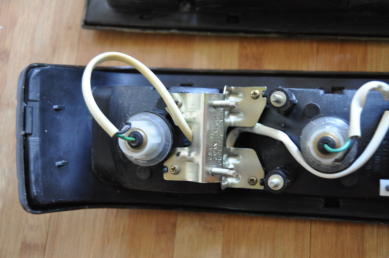

Slow progress still, but I bought some bits from re_japi in Finland, as they were in better condition than the parts on Kimi. Amongst the parts were a pair of rear light clusters, with some before and after clean-up pics.
Not much I know, but every step is getting me towards my goal  :)
Top cluster as recieved, bottom one after some cleaning
