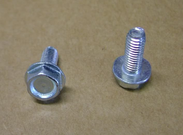

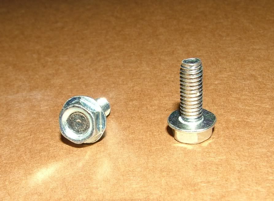

rusted bolts are the curse of the clasic car restorer...
luckily, Mazda used a self cutting bolt on the 1st gens and this really helps when rebuilding these cars.
When the car was built, Mazda welded in blank captives into the shell and then used 6mm hex head \'taptites\', a self cutting bolt that was driven into the captives, cutting its own thread as it went in. This saved Mazda pre-threading the captives first. It has a slightly triangular shank that cuts the thread.
I bought a big bag of these from my local fixings specialist and they just swap like for like with the existing bolts. I have swapped loads of mine and everytime I work on the car and remove one, I replace it with a new taptite and put a bit of copper grease on the thread before I screw it in to make it easier to remove in the future.
The taptite bolt...
The great thing about these is that if/when  you snap the head off a bolt, just drill a 5.5mm hole through the snapped off bolt and then drive in a new taptite.... most of the time it\'ll pick up on the original threads and the jobs a gud\'un. You don\'t even have to clean out all of the old bolt back to the threads. The bolts also look \'factory\' with the same 10mm head.
I drive mine in with a cordless drill...
I\'ll send you some if you like Cliff, they don\'t half save some work.

Good shout this one Ian and yes if I can take you up on kind offer, would be very much appreciated :Thumbs-up.  I\'ll look for some in the mean time too.
Brilliant idea though as it would save re-tapping the threads.  When I have previously drilled out the rusted bits I\'ve always re-tapped the threads and put bolts in - only trouble is although they look \'factory\' they appear to look a 25 year plus factory unit as mine aren\'t new-uns :(.
